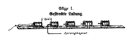

I know from my grandpa how they occasionally killed tanks in an ambush on the eastern front. They attached 3 or 4 AT mines and a rope to a wooden board and hid them on the opposing side of a road. When the tank approached they pulled the board on the street so the tank would run over it, triggering the explosion of the mines.
Hello Drake.
A modified ‘Gestreckte Ladung’ with Tellermines - known since World War One and teached also :wink:
[here with Handgrenades]
